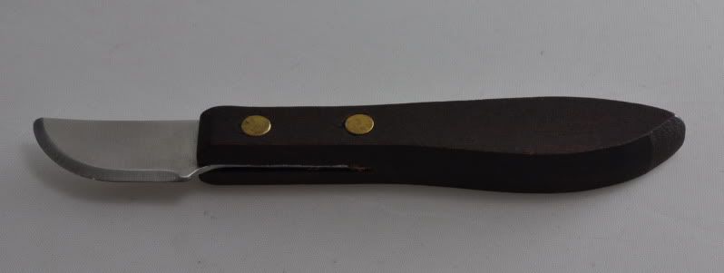

These tools can do the job:

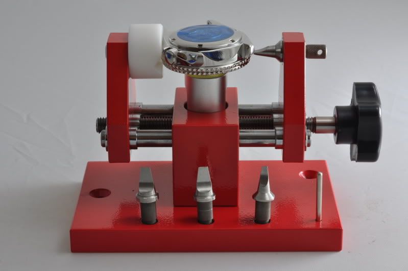

But this works great and very smoothly without the chance of slipping and marking your case

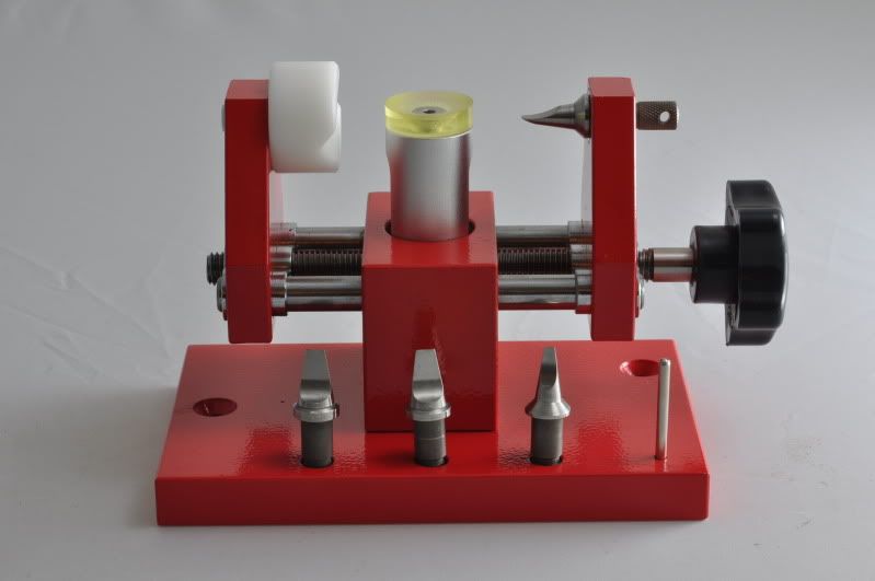

The white nylon bumper can be removed and two Chisels can be used on very tuff to remove bezels ...

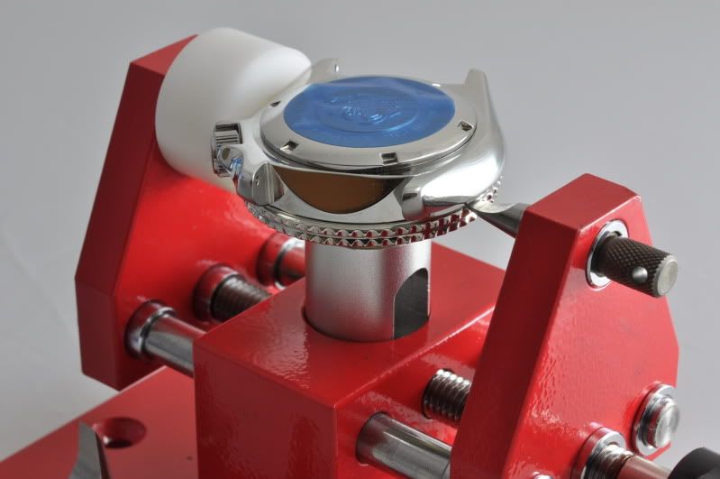

The watch is placed on the spring loaded support turn the nob to bring the chisel to the gap between the bezel and case, a bit of plastic film can be used on the chisel to stop scratching but I have found it is not needed in most cases ...
Turn the nob till the pop, the spring in the support will help to keep a little pressure on the watch and remove the bezel from the watch

Noah. Do you sell the exact bezel remover that you show in the last pic? Or, did you get that from Jules Borel? I need one of those my friend :santa:
